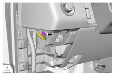

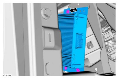

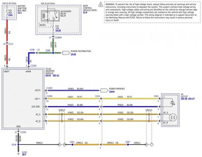

Although, judging from the original post on this thread, I'm sure you could help us find the wiring diagram for the inverter which we could piggy back on and add a connector for that factory outlet...

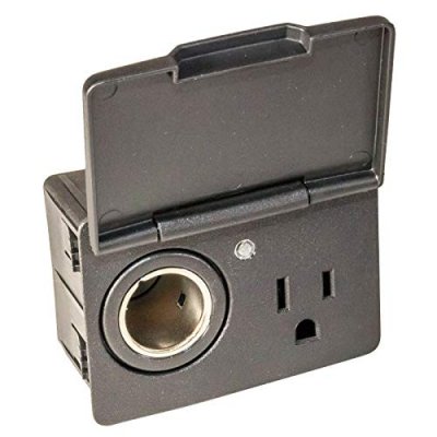

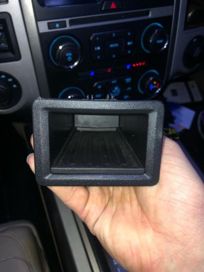

Which outlet would you use? this one ?

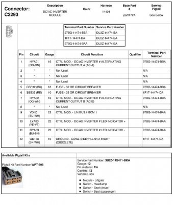

yup, they only have the 2015 Expedition available.
Fortunately for me that's my model year. I forgot I had AllData until you posted these [emoji849].
So, I guess we could use the pinouts on the inverter to add new leads out the back side of the connector, or we could use a crimp-on T-splice on the two AC lines.... Which would you suggest?

It's really whatever the user is comfortable with. Me I always go overboard; I splice and solder.
I'm the overachiever kid with the volcano project that actually spits out lava LOL
