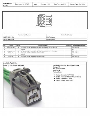

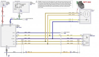

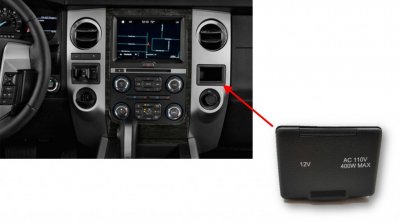

Took the Expedition Diagram and modified it; added the F150 110V outlet on it. So now it shows how the connections should be made from the Inverter (C2293) to the F150 outlet (C2292)
C2293 pin 10 to C2292 pin 6
C2293 pin 11 to C2292 pin 4
C2293 pin 1 to C2292 pin 3
C2293 pin 7 to C2292 pin 1
Thanks for taking the time!

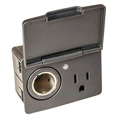

Got myself a 400W (F150) inverter, got the AC Outlet ... got some wires off ebay. Now just need to find some free time :)

That'll be handy, I never did get around to adding an inverter and wish I had. Where does the factory inverter install? I have a completely different year of course but curious where they were able to stash it.
