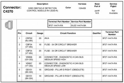

Wiring manual shows Parking Aid is a completely separate system.

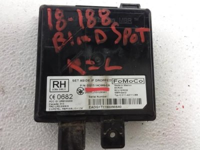

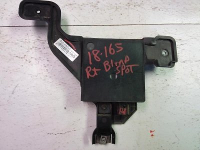

I seriously doubt you need a new bumper. There's no listing of parts that show a different bumper with and without BLIS. The system really is just the rear SOD module sending a signal and activating the LED in the mirror. Still not sure how the center rearview mirror is part of the system. But, yeah, you would need to replace your side mirrors, maybe the inside rearview mirror, and install the two rear SOD modules plus wiring. It's been done in the F150 more than once.

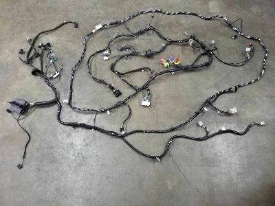

Most people do this sort of thing by replacing entire wiring harnesses to get the connections needed. That is really an unnecessary expense. Running new wires to the rear for the new module might be more practical. As long as you can get a connector(s) with pigtail for each module, you can make your own harness for considerably less money.

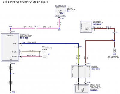

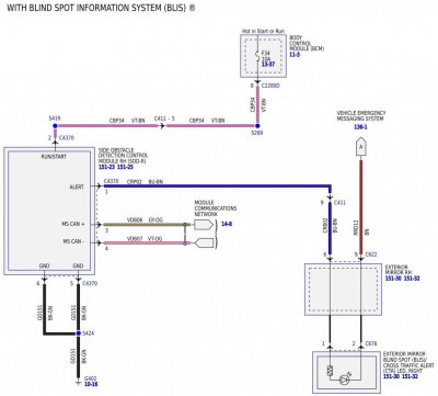

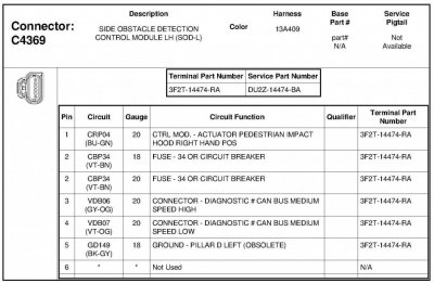

I don't know for sure, but I strongly suspect the powerfold mirrors use the same connector (C516, C622), but with pin 6 missing for the BLIS LED connection. You would need to get a spare connector/pigtail, or locate a Ford wiring kit that has the same pins, and then replace the glass with that used with BLIS and, of course, get hold of the LEDs. Those are a separate part with their own connector (C576). Note that this connector MUST be present inside your existing mirrors or you will need to add wiring for that as well.
It appears the BLIS LEDs are fed by pin 6 (from the SOD module) but get their ground from the Electrochromic Mirror circuit that is controlled by the inside rearview mirror. That appears to be why the inside rearview mirror is part of the circuit. If I'm right, there would be no need to replace the inside rearview mirror when adding BLIS -- just tap into the wire at pin 15 of C911.

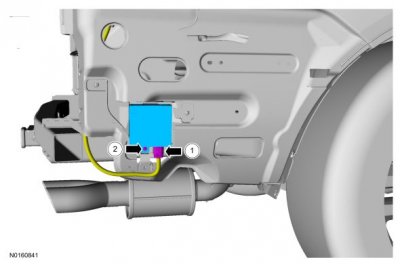

So, I would not call this a "simple" upgrade but it's probably not as complicated as something like adding a heated steering wheel. Once the mirrors are configured for the LEDs (i.e. either swap the mirrors or replace the glass and install the LEDs), then you need to run a wire from each mirror to the inside rearview mirror, obtain and install the SOD modules (left and right) with all needed brackets and hardware, and run wires from each mirror back to the corresponding SOD module.
