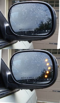

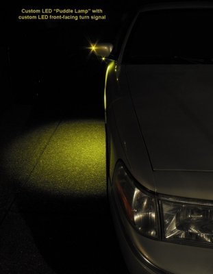

BTW, if anyone wants to tackle taking their mirrors apart, you could install your own BLIS LED pretty much anywhere you want. This way you could have your blind spot glass *and* BLIS at the same time.
I installed my own LEDs on a 2005 Grand Marquis where I added turn signal glass and also custom puddle lamps and forward-facing turn signal LEDs. It was a LOT of work but it was also a fun little project. The hardest part was getting the mirror glass out without breaking it. That was not easy!
Here are some pics of my custom mirrors:
SignalMirror-Daytime_72dpi.jpg CustmPuddleVsNewOEM_Annotated72dpi.jpg CustomPuddleFwdTurn_Annotated72dpi.jpg
The LEDs are called "bolt" LEDs. They are weatherproof and pretty much bullet proof but they aren't very small. They go in a 1/4-inch hole. I installed one facing down for the puddle lamp and another facing forward to make a front-facing turn signal.
These things are bright! You can control that by controlling the voltage and current flowing through them. So, you could have max brightness for a forward-facing turn signal and then whatever brightness level you want for BLIS. The advantage of doing this is your BLIS warning would be easier to see. The factory LED doesn't really get your attention -- especially during the day.

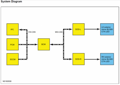

There will be some programming required in order for this to work. Each modules will require the vehicle's VIN to be changed to match. Then the IPC hex bit changes to enable BLIS & Cross Traffic Alert in the menu. If you've used Forscan before, that part is easy.
Here are the modules connectors Pinouts, if interested:
View attachment 33504 View attachment 33505
I just wanted to chime in as I am attempting to add this to my 2017 Limited. I have both modules and hooked them up to the truck. I haven't got them to work yet but I have some observations.
1) I have been looking at the AS-Built information for several platinum models and they don't seem to have the VIN number stored in the module. (I looked at this for 4 different VIN's and the As-Built configuration is identical) I did look up your 2013 Fusion and it does show the VIN in the AS-Built.
2) When you hook up the module to the truck, it only shows the SODR no matter if you have the ground on pin 6 or not. And this is the same for both my modules. This seems to lead to a Left and Right module, not address strapped based of the ground pin.
Another question, your attached images are for what vehicle? The diagrams I have do not reflect your images.
Any thoughts?
Any thoughts?
the diagrams are for the Expedition ... If you compare post#32 diagrams and post#36 pinouts they'll match

Under connector c4369 on your image, the circuit function for pin 1 says "ctrl mod. - actuator pedestrian...." and under c4370 pin 1 says "#N/A" but the pinouts for the wiring diagram show connections for the LED's in the mirror.
Any thoughts on my observations 1&2?
The way the manual describes the wire function sometimes throws me off too, but if you compare the electrical diagram, ... bounce wire colors and pin numbers you're good to go.
You're correct .... I noticed the same, unlike the Fusion there's no VIN built in for the Expedition's BLIS modules.
I'm not clear on exactly what you mean in your observation on #2, Care to elaborate, .. sorry :(

I took the two wiring diagrams on Post #32 and combined them.
Driver Side Module is on the right, I know ;)

Sorry, When using forscan to display all the modules, I only see the SODR module. According to the wiring diagram, grounding pin 6 on the module should designate an SODR module and leaving pin 6 unconnected should designate an SODL module. What I am experiencing is with pin 6 grounded or not, the module still shows up as an SODR. Additionally, if both modules are plugged in, I can't read the configuration data. This would seem to imply that the CAN address is the same and the grounded pin is just a status bit that is passed by the module to the computer to determine left or right.
So the BCM is not recognizing the difference between Left and Right modules. Could it be that the BCM needs an AsBuilt change to recognize that both modules are wired in !
