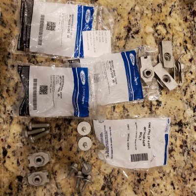

Finally had a chance to install the Raptor transmission skid plate today. The plate mounts to 4 places on the frame and the front edge attaches to an existing bracket. One nice thing is that it even has a removable panel to access the oil drain plug so you don't have to remove the skid plate for oil changes! Unfortunately the little access plate was on backorder, so I'll be picking it up in a couple weeks, but one of the photos below shows the cutout and view of the oil drain plug. Overall, this is what the Expedition should have as standard. It's much more robust than the standard plastic shield. Prices for the skid plate and hardware are shown and are roughly $200.
View attachment 28531 View attachment 28532 View attachment 28533
Hi Scott, thank you so much for all these information. I plan to do the same thing as you did. One quick question, do you happen to have the parts number for the removable panel to access the oil drain plug from the Raptor transmission skid plate? Thanks a lot.
