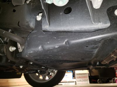

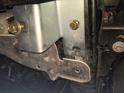

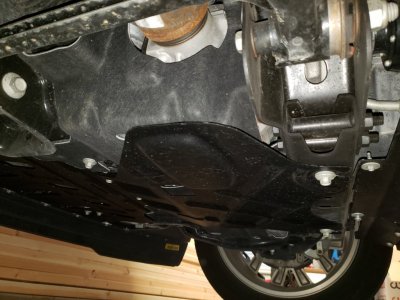

Scott, in this picture there are two side clips that don't seem to be on the parts list.
Do you recall if these side clips included with the shield or are they separate part numbers.
img_1011-jpg.28534

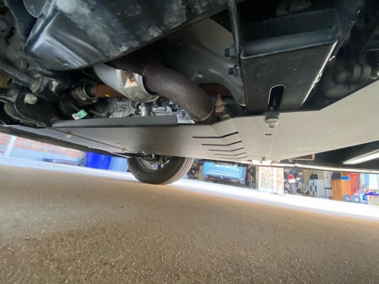

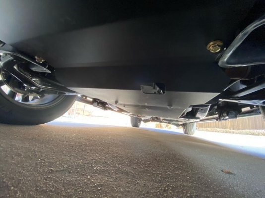

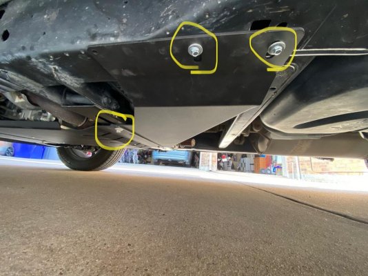

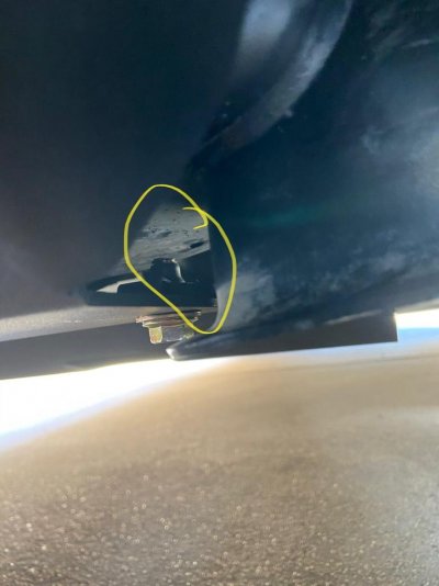

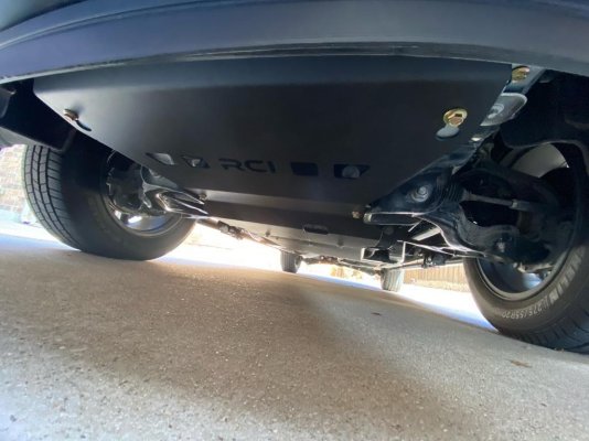

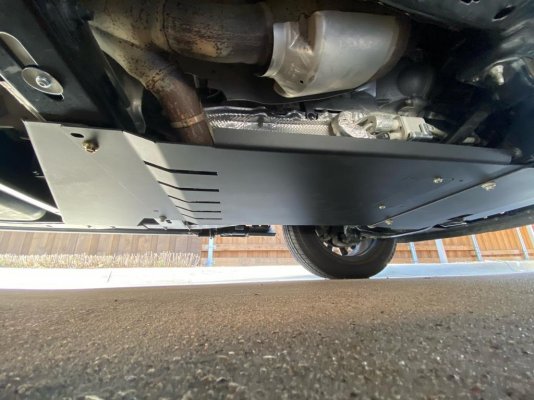

Sharing and aftermarket option. RCI Off-road F150 skid plates installed on a Expedition Max Limited 4X4 with Towing Package. Cost is $575 shipped with all hardware and I found a coupon for 5% off that.
3 holes had to be drilled in frame to get the rear diff plate to work(circled in photos).
Very front and 2nd plates attach together with bolt and speed nuts (not in frame and circled in photo) and still very sturdy. Supplied bolts there were trimmed down to avoid any chance of rattle. If needed, could drill frame there too and install speed nuts.
I removed all other shields when installing this. For oil filter access, will have to loosen front two bolts (slotted) and remove back two bolts. There is a oil plan drain plug access door. Pretty easy.
img_1011-jpg.28534
Check out posts 83 and 84 in this thread. Part numbers for the brackets in question are # JL1Z-6G079-A and # JL1Z-6G079-B

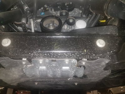

Hello guys!
Anybody can help with the part number for the items related to fuel tank skid plate and accessories/fasteners for the MAX version?
Will be really helpful if somebody can post a overall picture under the car with all skid plates in place (an FX4 or a regular Expy with all skids installed).

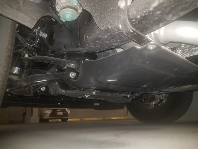

I made a fast check under my car and I identified 3 skid plates already installed from factory - please refer to pictures below:
Beside the transfer case plate (i guess not needed since 2WD model) and the fuel tank one, can somebody support me in indicating which skid plates are missing?
Thank you in advance!

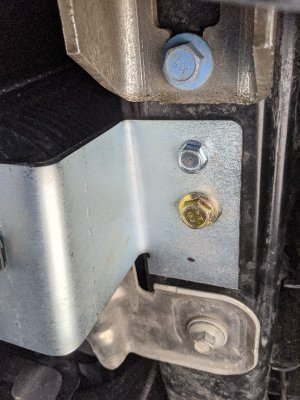

I undertook the RCI full skid package install today, and for one thing, they are really well built. I can't believe that for the price of these things, they effectively use cardboard skids on the most important parts of the vehicle.
Overall, the install wasn't too bad, getting things lined up was a bit of a pain, and as @cmurphy2 mentioned, I did have to drill one hole in the frame to get the transfer case plate installed, one of the holes actually lined up, and luckily I was able to use the existing square cutout for the speed clip. I also cut the two bolts between the front plate and the second plate, I may actually drill holes in the frame in these locations and put self tapping bolts in as well, just to keep it more secure.
The biggest issue I had with this whole install though, is the two front brackets and the fact that the brackets weren't long enough to get both holes on each to line up. You can see in the picture, that they are a good inch off, and this causes the intercooler mounting bracket to sit angled once everything is together, I think what I'm going to do is take the brackets off, one at a time, and cut them shorter, and drill a hole through the bracket into the frame, and use self tapping bolts to put one more bolt in each bracket. I just don't really like the intercooler bracket being kind of angled like that. Anyone else run into that?
Otherwise, I'm very happy so far.

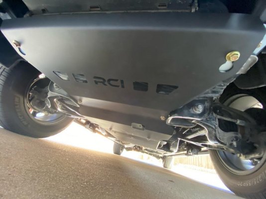

Thought I'd post a few new photos. I went ahead and pulled off the front skid brackets, cut them shorter (cut exactly 1.25") off of each one, so that my intercooler bracket properly sits flat on the frame rail. I also drill two holes in each bracket, and used some self threading bolts from my local Ace to give them two mounting points again.

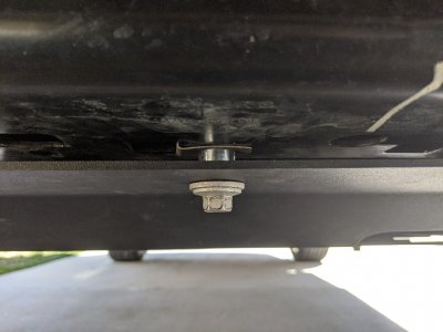

Finally, the other picture shows how I supported the second section of skid on the crossmember. This will help ensure no rattles and makes it a little more sturdy in the center. I used one of the existing speed nut and bolt pairs, and one of the existing holes. I just drilled one hole in the second plate. I also threw in a 1/2" steel spacer (also from Ace). Way more sturdy. And it was in just the right spot not to interfere with the first plate. IMG_20200329_150131~1.jpg
