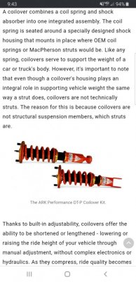

What year models are equipped with these springs? Just curious if it went back to 2010. I hate to be that guy but with all due respect, these vehicles are not equipped with struts. Struts attach to the steering knuckle and rotates as the knuckle turns. Also strut equipped cars lack an upper control arm. Ask the Mustang guys. They are incorrectly listed as strut assemblies through a number of part sources but technically they're big ass coil overs.

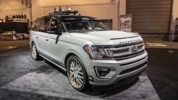

Not sure if this one was lowered or if it’s an illusion due to the giant wheels. Eibach could probably make you a custom set that would ride nice.
