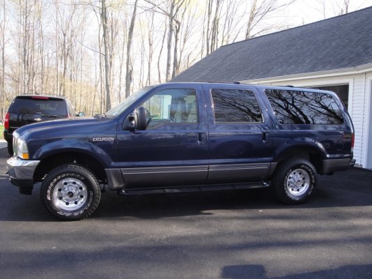

If only Ford would wise up and make a next generation Excursion. There are tons of people out there in the same situation, right at the limit who need just a bit more payload.
From your lips to Gods ears brother. I'm sooo sorry I sold my Excursion, should have kept it around just for the towing trips - of course when I sold it I thought I would not be towing any longer. DSC03329.JPG

From your lips to Gods ears brother. I'm sooo sorry I sold my Excursion, should have kept it around just for the towing trips - of course when I sold it I thought I would not be towing any longer. View attachment 74347
Is the payload that much different with the Excursion? I am reading 1400-1700 which is what we have as well. Maybe they underrated it back then. Some guy said they have a 7k lb axle in the back which would be a big difference. Wish I would have bought one a couple of years ago, the prices for them have doubled in many cases.
