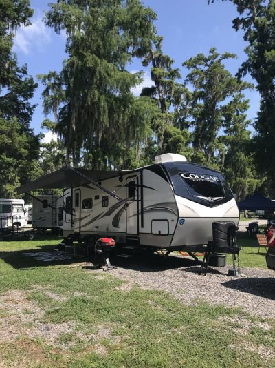

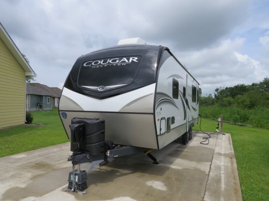

Wife and I downsized to a couples travel trailer. 29-10 including the front part of the frame that holds the battery..propane tanks and coupler. 25 ft of inside space. Its a Keystone Cougar 25RDS and very popular for 2 and does have a dinette in the rear that can convert into a double bed. Probably loaded it would be pushing the limit on my FX4 with the max tow package. Hitch weight of around a thousand pounds is heavy. Using a 4 point Equalizer WDH and have 3.73 gearing and 10 ply BFG tires. We try to keep the load in the camper and the Expedition as light as possible. Have a payload of 1769 lbs so thats up there with many F-150's. I've been towing at 60 to 62 mph and its easy to handle except in high sidewinds. Get 9 to 10 mpg towing at that speed and it can go through the 23.5 gallon tank very quickly. Gross weight of the camper shows 8800 lbs but I keep it in the 7500 lb range. Do your homework before buying anything.
