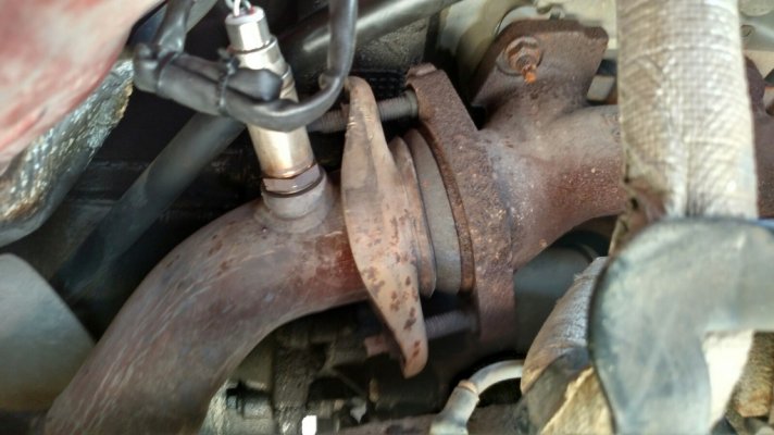

I can't speak to the 5.4 exactly, but I changed both on my 4.6L. I gave both sensors a good shot of PB Blaster before, then it was just a matter of finding the right angle to get the wrench on it. Thankfully the PB worked & it took very little to break the threads loose. The really hard part on mine was getting my hand in there to reconnect the wire harness.
On my 5.4, the sensor is elsewhere. Imagine the sensor in this picture is at 12 o'clock, my sensor would be at 3 o'clock, moving towards the engine. There just isn't any room to move a tool one it's managed to be placed on the sensor. I ended up snapping the sensor with the tool from autozone. I've been driving like this since this thread was created. I gave up! The only way I see is the exhaust needs to be dropped. This is insane by FORD!

The Colony, TX
I think I ended up using a flare wrench on the sensor nut, but it's been awhile. The wrench is fairly short & has a more acute angle than a standard wrench. I just remember there was very little choice in angle to get at it, though my pic makes it look fairly accessible.
