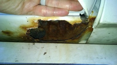

Amazing timing on this thread. While I was under the truck on Saturday changing the transfer case fluid I noticed a little paint bubble on the front passenger side rocker. Went to touch it and my finger went through. Picked away at it and ended up with this:
Hand for size reference.
I'm disappointed but it's not the end of the world. Cutting/welding new steel is cheaper than taking on fresh payments; and really, anything is going to rot with all the road salt that gets dumped in the northeast.
I've found "slip-on" rocker covers for cheap, but I don't like the idea of just covering up the problem. I'm thinking the approach with these would be to cut out the rust, coat everything exposed with a rust converter/preventative, and then install the covers on top.
https://www.ebay.com/itm/Ford-Exped...-Side-Slip-On-Style-Rocker-Panel/232004375176
Does anyone know how compatible the F150 rockers are with our Expeditions?
I'm not looking to use the full length -- just the front foot or so. There are plenty more body panel parts available for the pickups and if I can scrounge something useful from the panels available on the market, this could be a decent afternoon and a reasonably proper fix.
I'm planning on coating my liftgate in white bedliner in the near future and might tie the rocker fix into that project. If nothing else it'll make the mismatched white color look more deliberate. For the short term I sprayed rust converter on all the exposed metal I could reach to try to slow the rot.
Anyway, F150-to-Expedition rocker compatibility. Anyone know what's what with that?

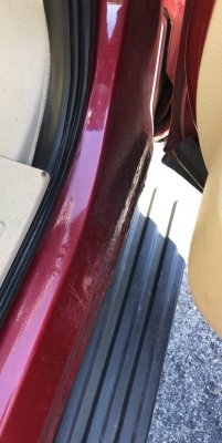

I’ll likely be replacing mine either this weekend if not then then first week in August. Sick of looking at this:

Nice, but I've yet to find anything definitive in terms of what lines up with the '07+ trucks.
May just have to wait a few more years for more trucks to rot out. Once there's a bigger market for replacement panels the manufacturers generally step up with products.
6,511
3,124
I purchased 2nd gen panels for mine, they look to be the same minus a few minor differences. Door openings, pillar, divets all appear the same and I put it up to my old ones and they match up pretty well. There may be some differences where it attaches behind front fender but I’m slicing that part off the new panels anyway as I’m not pulling fenders. The bottom angle may be slightly different too but I’ll be making them fit one way or another lol, if i have to I’ll bend up new tabs with a different angle and weld to the inner rocker. They sell slip on rockers for “03-17’ Expeditions” but I’d rather replace the entire panel with the oem thickness steel.
