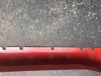

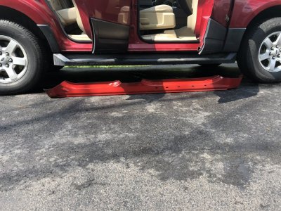

6,530
3,140
Apparently aftermarket companies aren’t going to step up to the plate and have no interest in selling panels for these trucks. Still haven’t tackled mine, I’m sure the 06’ OEMs I have are NOT a direct fit there will be alterations made. The slip on rockers are listed as 03’-17’ however. The BS excuse by ford that “it’s a part of the door frame” is a big smelly pile of crap. The 06’ and 07’ panels are 98% alike as far as I can tell. I rattle canned mine a red temporarily so they don’t rust in the garage.

Those look damn close to the right fit. Where are the differences you're seeing?
6,530
3,140
I don’t see many. The angles and door openings all appear to be correct. The only thing I’m not certain on is if these tabs that go up onto the inner rocker will be matching up....but I’d think anyone can be creative and make it work by fabricating something up.
