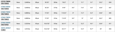

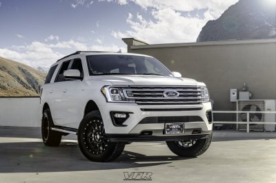

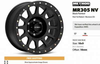

Any suggestions on what size tire to run with this lift? I know the website says up to 35" with factory offset, but I'd like to run the wheels below. My main concern is allowing full suspension travel without any rubbing.
Preferred tire: Cooper Discoverer AT3 XLT
I'd like to run this wheel:

Either 35/11.50/20s or 33/12.50/20 on STOCK wheels will work no rubbing or trimming. Put them on anything other than stock wheels and I can’t guarantee you’d have zero issues

If you go +18s you will have a lot of rubbing On 35/11.50s. I have 35/11.50/20s on my 16 with 1.25” bora adapters and I have to trim a lot of the wheel well, fender, and move power running boards back. With the adapters, it’s basically like running a +12 over +44 wheel

Good info. Thanks, guys. Might just stick with stock wheels for now.

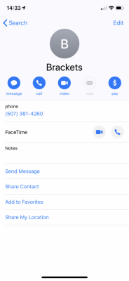

There are two people that make the brackets needed that I am aware of. You also need to find a shop that is willing to work with a little trial and error.
Attached is our 19 stealth with CCD
Can you please show me who make the adapters? I am ready to buy them now.. got the readylift kit. Thank you.

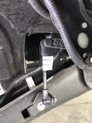

Just wondering if these are the sensor links that need to be replaced when doing the lift on the ccd rides ???? Anyone that has it done can you post some pics of the stuff needed. It would be very helpful.

The little I gathered is that I am correct that these are the height sensor brackets. ..the good thing is that I did the same with my 2015 grand Cherokee and made extras brackets. I just need to adjust to size...So now I have the readylift and the linkage brackets all that’s left is the fun part wheels and tires.

bumpity bump... anyone with the readylift kit on a platinum know if those are for sure
the links I need to adjust??

Have you contacted Readylift? They’ve had to have done one with those brackets, I would think

This is correct for the CCD. I am going to do mine in a couple months. I talked with MIEKKupload_2019-4-10_6-2-54.png about this, he sells/makes adjustable links so you dont have to move the actual brackets. Should be pretty straight forward and from what I have seen jacking up the vehicle the adjustments are not too crazy for the 3/2 readylift setup.

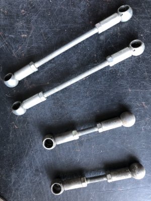

yes we kow that what is says on the package.. but its not hard to make those brackets to keep the sensors level.. that's all that needs to be done... I have an extra set I made 4 for my grand Cherokee air ride to lower that truck a little more...kept them and I know why now.. I just need to adjust them to size....I will post when I decide on rims and tires....
