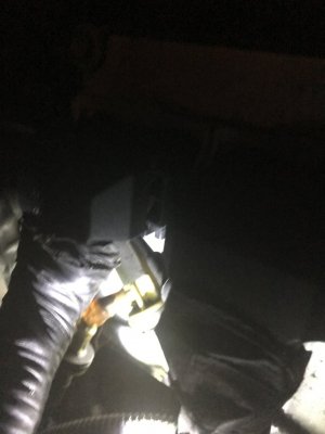

Anyone know what this vacuum component is?
kcexplorer
Jan 18, 2018
Missouri
Hi there, I recently posted in regard to a likley vaccum leak on my 2003 expy xlt. I was getting p0171 and p0174 codes. I checked the PCV elbow and it looks good, however I did find leaks here. With the left hose disconnected (see picture) the truck ran and sounded okay. I took a broken piece of the connector to connect it for the time being. I would like to find out what this piece is called so i can get the elbows replaced. Thanks for your help.

It's a check valve. One inlet / two outlets. Do you have a junk yard in your town ? Or are you just talking about the rubber hoses ?

Thanks. I replaced the hoses, but idk about the valve. I have a vacuum leak and problems with HVAC system only blowing through the defrost (possibly due to loss of vaccum). Any way to check if this check valve is bad? If it is, does anyone know if it would cause a leak?

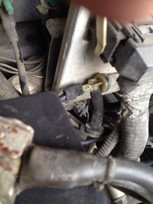

I'm think that might be the one that disintegrated on mine and caused air to only come out my defrost instead of panel & floor. I replaced the hoses and it instantly fixed air blowing inside cabin. 2003 EXPY Hard to tell exactly without taking computer out to engine compartment.

Yes, same connection ... I replaced a hose ... had to remove battery to get to it.
I just took a lousy picture but that fixed the defrost only problem.

Great. I have plenty of hose so I will pull the battery and inspect the hose tomorrow. Thanks so much!
