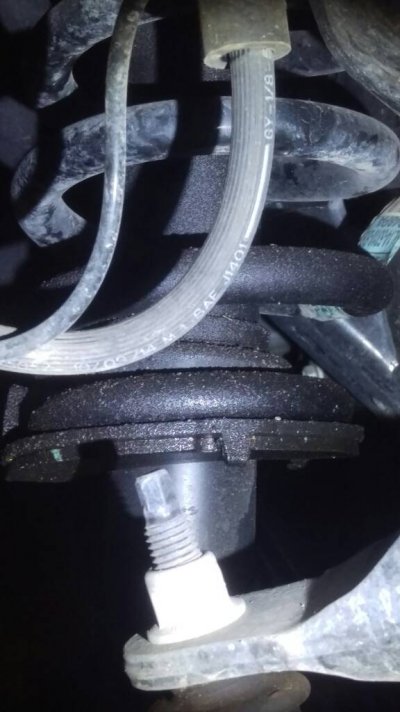

Take a look at these two pics and tell me if you think these front struts are bad. This is the driver's side but they both look like this. If they are in fact bad, is that something that I could get changed under warranty? I also have an extended warranty that I bought thru the dealership...car currently has 34k miles on it. I'm thinking this may be the cause of the hard ride we've been experiencing.

From those pics I would say they are shot. Take it in to the dealer and see what they say. Then you will know if they are a reputable establishment.

What year is your truck the standard warranty is 36,000 miles so they should be covered. Particularly with your extended warranty.

Dropped it off at the dealer this morning, just got a call they are replacing both struts under warranty.

This has been talked about extensively before. Ford OEM struts are garbage. I went thru (2) sets of 4 in 15k miles. First set was under warranty, second set was not. Would not have made any difference anyway. I was not going to put a third set of that crap on. I have been very happy with my Bilstein's. You will be replacing those warranty units soon.

Probably. I actually noticed them leaking a while ago but had forgot about it. They looked much worse now than they did 15k ago.

Yes I was pretty disappointed. I don't believe they have changed vendors. Basicly they are Monroes. And in recent years they have been very poor. All 4 were initially leaking badly by 5000 miles so keep an eye on yours. I think that is an area that Ford could specify a higher quality product but apparently they are cutting costs there. I believe there are many more out there leaking and people just don't know it because you really can't see the strut unless you get under the truck in most cases.

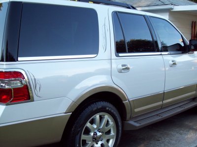

This is mine in the XLT. Only year they offered the King Ranch wheels as an option and I love them. This is a picture that a vendor uses on ebay to sell the SS door and window trim strips. I have also upgraded to the SS Roof Rack Rails since this picture.

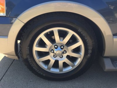

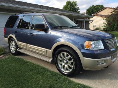

I put the King Ranch wheels on my old 05 I bought them from a guy in Texas, He shipped them to me. They came off an 2010 F150, I just changed the sensors and they looked great. Here is a picture of it. It had air suspension with the kneel feature so it always squat down when you opened the door to make it easier to get out and then it would air up when you closed the door and put it in gear.
Its 'blue', and it kneels. Hmmmmm.......
Thanks Andy. Cool that you like the KR wheels too. I had a 2000 expedition with the 4 wheel air suspension as well. Really like it but it is expensive to repair if needed. Luckily I never had to.
View attachment 21716 View attachment 21717
That was a great looking 2nd generation expy. I still have my 03. I decided to keep it for towing and use the Navigator for pleasure cruising.
