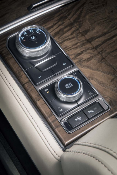

On versions with the low range transfer case (HD tow), the choices are 2H, 4A, and 4L. The last button around the transfer case choices is the rear locker button. No specific button for 4H.

Unless I am mistaken, the 2018+ uses the same transfer case as the pre-2018. So, it has the same 4H capability but that is selected by the drive modes (sand, mud, etc) vs a button that says 4H. It is still electronically splitting the torque 50/50 vs my jeep that mechanically locks front and back together with a lever pull. 4A should be splitting things 0/100 unless it detects slip then it automatically adjusts. Drivetrain is engaged in 4A so you do see a little mileage hit and hear a little noise.
