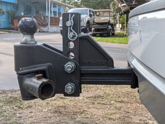

Here is my sway pro receiver, @Deadman...
The extra positions are good for different vehicles. If you have a 3/4 ton of larger pickup and the expy, you'll want the 9 hole deal instead of this 7 hole one. It can go either way, so, not sure how many combinations this is. Their set up instructions are awesome. If I didn't have this on my Tacoma before I got the expedition, the single two position one would've worked that I saw on blue ox website. No matter, I use the exposed holes to keep my pins handy/home and this lump usually lives in the garage of the camper unless I'm connected. I find it works great for my 7K# camper. Believe I have the 1000# bars... Someone in the campground told me I need to get a Pro-Pride, but, that one seems like a lot of screwing around to get right/connected. Not to mention $$$... The sway pro "came" with my camper when I bought it. No complains, but, definitely pick up a couple extra pins that hold the bars in place on the receiver. I've sheared one off and had it rigged up while I awaited shipment from blue ox (they sent them free, but, maybe ask for a couple after you have it in hand as the fella I talked to said "sometimes that happens").

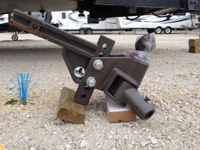

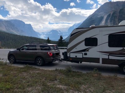

Mine is midway down because the trailer is fairly high - I would think a 9-hole is low enough it would start hitting the ramps into parking lots/gas stations etc. 2nd shows the height of the trailer - note the tongue is welded below the frame or I would have had to flip the hitch mount. As it is, it's just high enough that the Expy tailgate hits the power tongue jack... :-(
Oh and this photo is with the 750 lb bars the dealer sold me. I've since upgraded to 1000 lb bars to move more weight off the rear axle. It's borderline as it is now for RAWR.
Last bit of advice - with the Blue Ox, don't try to unload the bars when the trailer/truck aren't in a straight line and all the weight is on them. I have the stitches above my left eye to prove it...

:) Stopped for a break at the Columbia Icefields glacier on the way home from Jasper... at least I assume you're talking about the scenery!

You know, I have no idea if mine is the underslung head. The trailer guys supplied it and I didn't even know there was a choice. And the pictures look identical on the Blue Ox website (compare the BXW4011 and BXW4012). Given their description I should have gotten the underslung, but does anybody know what the difference in construction is?
My GVWR (trailer) is 7240 lbs, and I found the 750 lb bars insufficient. Not enough weight transfer to the front. My tongue weight is near 900 lbs and the 1000 lb bars made a noticeable difference in stability. I have to believe that every combination of truck and trailer is different so the recommendation isn't always the same.
