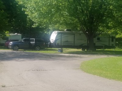

I have a 30' TT that I have towed with my standerd length '09 HD tow package, but not yet with my '18 Max Platinum HD tow. I anticipate that the '18max will do a better job. My TT weighs 6,300# empty and I do tow it empty. I never fill the water tanks and pack lightly on food etc. IMO it is all about the payload of your Expy and not the length. I think you will be right on the edge with the above listed TT, and if you do not go up to the gross weight rating it is doable.
