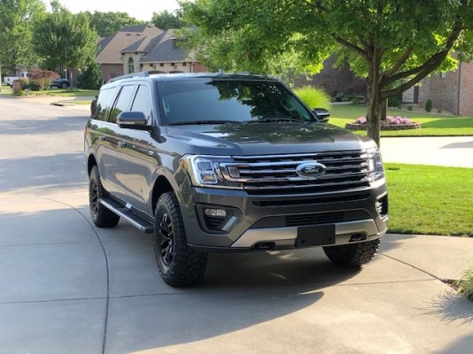

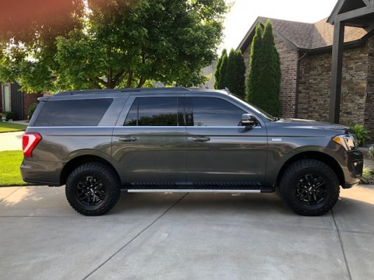

My FX4 Max with HD Tow
1900lbs payload is higher than my 2020 ranger truck ... which is a stripped down low tech speedy two seater that just happens to include 6ft truck bed. I only bought it because My kid needed his first car and I wanted to avoid buying a utility trailer for furniture and yardwork.... but its limited to 1800lbs, if I remember correctly.
1900lbs in expedition is astounding.... sort of like finding someone with the heavy duty high payload F150 XLT rated for 2200-2500lbs.00136466883aafd02650527153bf1ac0.jpg

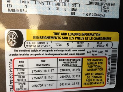

I have a payload of 1767lbs for my
2019 Expedition Max XLT, 202A, 4x4
HD Tow Package, no panoramic sunroof, 20” alum wheels. The seats are not leather (ActiveX) and 2nd row are bench seats.
It does have the Driver Assistance package and Nav. Other numbers are:
GVWR: 7720
Rear GAWR: 4380
Front GAWR: 3550
When purchasing I did not realize the variation in this number but I have started towing a travel trailer and having this payload budget has been helpful. My main efforts have been more on keeping an eye on the Rear GAWR and keeping the tongue weight below the 900lb limit.
