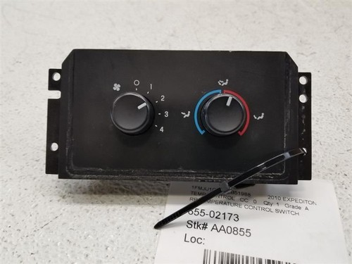

Oh it's already starting to drive me nuts lol. I did notice that on the rear controls that are for the back passengers there is a mode setting that's also around the temp setting knob. You can see what I mean on the link I include for a spare control for rear. I never noticed that before so I can't really determine if that's what's happening. But it makes sense in the sense that heat rises, but also no sense bc why wouldn't you want as much hot air as possible when it's cold.
