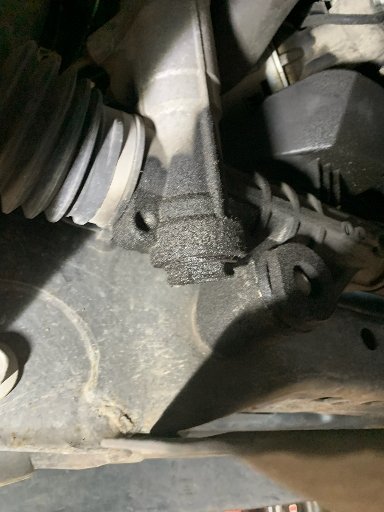

Here the pic here sent. I'll tell him to hold off and I'll have a look at it.

Are you losing a lot of PS fluid? If not, then just add some every few weeks / months. From the picture it looks like it's just "sweating", not leaking (lots of old road debris stuck to it + no sign of droplets).
There are also products that can help re-seal (swell up) gaskets in the system to stop leaks. Could be a cheap fix. If not, then you can always replace it as a last resort. It shouldn't be too complicated, lots of space to work on these big Fords.
