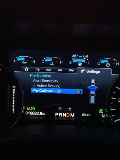

Post #10 in this thread gets it right...according to the manual, the "distance alert" feature (the one that supposedly displays the colors) can be turned on and off. I will look for it next time I'm in the vehicle. It also says that particular feature is disabled when adaptive cruise control is activated.
aggiegrad05
Nov 6, 2017
1,834
1,392
North Texas
As I suspected, the available menu options don’t reflect what the manual says they should. Unfortunately.
Note: not a dadgum thing about distance indication
