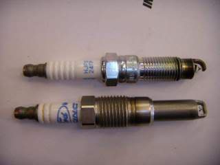

The 3.5 are definetly easier to change than the 5.4. 04-08 5.4s have a wild spaceship plug that was originally a 3 piece that could break but the new ones sold don’t.... late 08 plus have a regular plug after the head change.... it’s time consuming but not too bad. Top is the newer plug bottom is what I have:

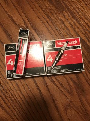

I’m gonna be tackling this on our 2015 tonight. We have 58,000 miles and probably 10-15% of that is towing fairly heavy. The fuel mileage has seemed to drop off a little lately so I’m hoping this will fix it. I went ahead and ordered the new boots with the plugs. This is what I bought. 7b1b31a7194b76a3575b9ba27f773031.jpg

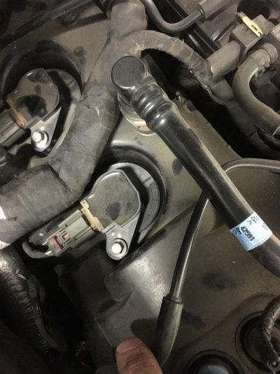

Just finished my plug change on my 2015 and it was cake. No issues with the boots coming off the coils and sticking to the plugs. Only issue I had is that I was anticipating the coils to be harder to pull off than they were and I broke a small piece off of the flat part of the first one (see pic). I’m pretty sure all that part does is put pressure on the gasket to create a better seal. May go price one at ford. e347fd32391598a7810ebd19a45f0ef4.jpg

Yours must have been replaced or inspected at one point. I was laying on the engine, with a pry bar tool hooked under the coil pack and tugging for all I was worth. The cop would lift out but not pop off, and when you released pressure it sucked itself right back down onto the plug. I don't think I've cursed so much on a spark plug change ever. Here is the tool to remove the boots if they get stuck:
Ripped Spark Plug Boot Remover https://www.amazon.com/dp/B00CE9XZI4/ref=cm_sw_r_cp_apa_i_pmbhBbATCJDWD
I put dialectic grease (as I've done for every spark plug change for the last 20 years), so the new ones pop out now. Once schedules slow down over the summer, I'll tackle my two stuck boots by either making my own tool or buying the overpriced one on Amazon.
