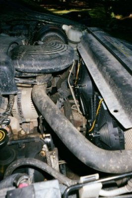

Alex, 6hp gain is assuming that both fans are running. Obviously, if the fans are not running, then you gain just that much more. As for me setup, take a look in the attachments. As you see, it opens up the front of the engine very nicely and makes changing the serpentine belt super easy. Granted, accessing anything on the front of the engine is now super easy. I am running dual fully adjustable controllers. So, I can set the temps to whatever I want. In my case, I have the controllers set up about 5-10 degrees apart and I have indicating lights on the dash. I did this so I can keep an eye on how hard I am pushing the truck and if I need to take it a bit easier. I have never had both fans kick on for me other than the 1 time I was in Atlanta in 100F weather with the A/C blowing full blast and a module that decided it didn't want to play. Other than that, a single fan was all that I have ever needed.
Walnuts, If you want to do it when I am in Rochester, let me know. It isn't all that hard to do. Now, I did go a bit more on the expensive route as I spent about $300 on my setup. But then, I also routed the power through the factory fuse box (so no extra wires off of the battery) and I used dual controllers.
