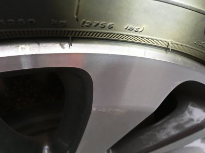

Nope. Maximum tire pressure on my P-metric tires is 51psi. GAWR is handled at 35psi with these tires. Since the tires are also rated at 2756 pounds each (5512 for the pair) they can easily handle the GAWR of 4300 pounds noted earlier.
The truck and these tires are fine for towing.

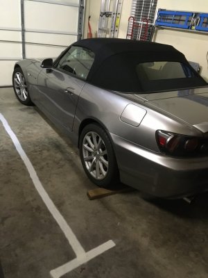

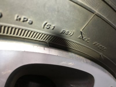

Photo is minutes old. They're P-metric tires that came on my new '17 Expedition 2 years ago. Similar tires were on my '07 Expedition. That's what comes on these trucks.
Added: Just walked down the garage and checked: The Maximum tire pressure on the tires on my lil' Honda S2000 is the same: 51psi. No one would mistake either the car for a truck or tires for a light truck tires. These are, of course, flimsy P-metric tires (255R40/17). :)
-- Chuck

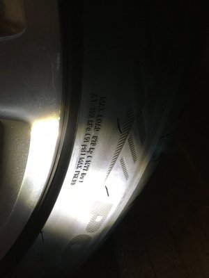

Why would google know more about the maximum tire pressure on the tires on my truck than I confirmed yesterday -- and furnished photos? For grins here's the maximum load and cold tire pressure from the rear wheels of my lil Honda S2000. Yep 51psi (again). 1477 pounds capacity.
I really don't care if anyone wants to run truck tires or change their oil at 3,000 miles. Overkill always works...but it ain't necessary. :)
