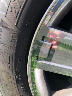

Photo is minutes old. They're P-metric tires that came on my new '17 Expedition 2 years ago. Similar tires were on my '07 Expedition. That's what comes on these trucks.
Added: Just walked down the garage and checked: The Maximum tire pressure on the tires on my lil' Honda S2000 is the same: 51psi. No one would mistake either the car for a truck or tires for a light truck tires. These are, of course, flimsy P-metric tires (255R40/17). :)
