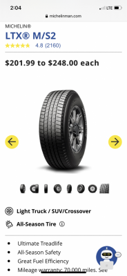

Yes, the lowest LT max pressure is 41 psi for the C rated, 65 for the D, and 80 for the E rated.So, I've been trying to figure out what rating my Michelan MTX tires are? It doesn't seem to say "P" rated or anything like that anywhere. I'm assuming because their max inflation is 42psi that is what they are?

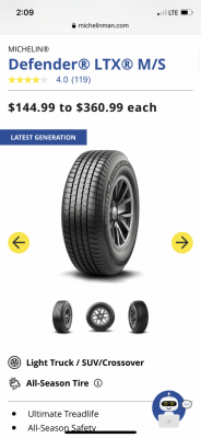

Defender LTX tires are light truck tires.
I don't see the max pressure notation on the tires but my eyes ain't that good.
