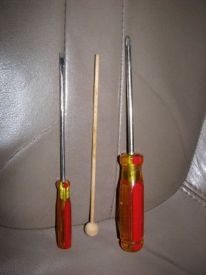

Tools need: phillips screwdriver, standard screwdriver, 1/8" rod/stick
The only tools I needed were phillips screwdriver, standard screwdriver, 1/8" rod/stick (this was the "handle" from some rockcandy my kids had, but anything about 1/8" dia and 3-4" long will work).

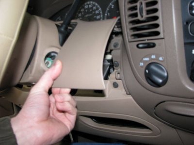

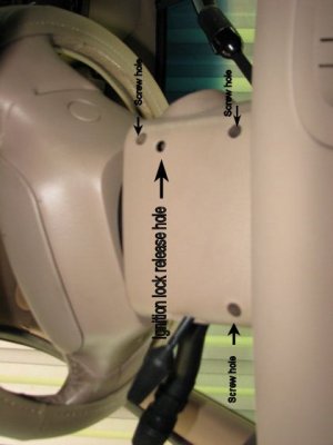

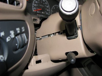

The bottom of the steering column.
These photos show the bottom of the steering wheel where the 3 screws and the release hole for the ignition switch is and also me removing the column covers after the ignition switch was removed. (Besure to disconnect the battery and wait 2 mins before trying to remove the ignition switch - don't want to accidently set off the airbags!)

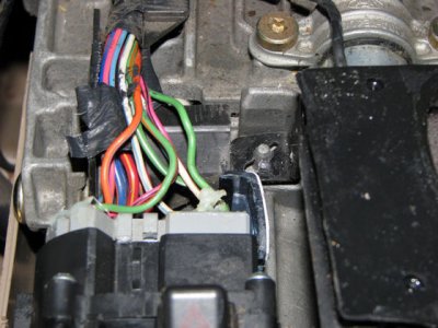

The problem found and fixed!
These two photos show the multifunction switch and the problem plug connecting into it. Just to the left of the HAZARD LIGHT switch you can see the "L" shaped piece of plastic I used to brace the plug (it has double-sided tape on the right side to hold it in place).
I tested this "fix" pretty agressively, making sure I wasn't pinching wires and that the steering wheel height adjustment had full movement and the brace worked perfectly! (Look closely at the top of the grey colored plug in the back of the multifuction switch and you can clearly see the broken tabs of the retaining clip.)
I'll have to replace the broken plug eventually, but for now, I have turn signals and hazards!
