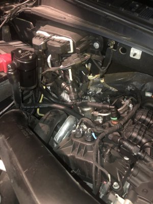

After much study, I decided to go with the JLT for my 2018. She only has 7500 miles, so hopefully I caught it early enough. She will be in our family until she crumbles into dust, so my rationale is that at worst I will keep my intake cleaner for no reason. At best I could save a couple of head replacements or cleanings and have a better running engine long term. Total was under $200 with the can extension. When installed I couldn’t get the engine cover to sit right with the hose routed from the PCV toward the passenger side. There just isn’t room for that hose. Then I noticed on the bottom of the engine cover there was an “imprint“ of the PCV connector and hose going toward the front of the engine. This is how the original hose is routed, toward the intake. So I tried routing the JLT hose forward, and I found the clearance I needed to properly seat the engine cover. I made a small half moon cut on the front of the engine cover to accommodate the hose. The rest of the install was very easy. I then did a 250 mile trip towing a 2000 pound covered trailer. With a drumroll and an audience I pulled the catch can and... not a drop! I verified the hoses were routed the correct way, then felt the screen of the oil separator and I did get a haze of oil on my finger. I won’t check it again for at least 1k !!
Big thanks to all the recommendations and input on this topic. And a shout out to JLT. I was very impressed with the manufacturing quality of this item, and their outstanding communication.
I think I did the same modification. Do the pictures look similar?AC9ECD50-89D2-4F72-9ADA-D5096FE86CBD.jpeg99F0F6BD-FE0D-4773-8043-2CD06727FB1C.jpeg

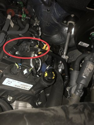

I’m not very familiar with turbocharged engines. One thing I noticed was the passenger side PCV system dumps directly into the intake manifold. The intake manifold is pressurized when boosting. I think this means that the passenger side is only effective when the turbos are not boosting.
It looked like there may be another PCV system on the drivers side. It connects on the intake side of the turbo, thus it would always have some vacuum. I also noticed an electrical connector on the hose. Does this open up a valve when there is boost being developed to allow crankcase pressure to be vented?
The one on the passenger side should be able to develop more vacuum when not boosting due to it being after the throttle plate.
Does this sound correct? If so then it seems like somebody who is mostly cruising (not boosting) will collect the most from the passenger side. Those towing (constantly boosting) may collect more from a catch can on the drivers side. 184F500D-C1E0-455F-941E-A305155122FC.jpeg Drivers side PCV?

I think I did the same modification. Do the pictures look similar?View attachment 38363View attachment 38364
Well, no, but it’s the same idea. I think yours looks better! My objective was to get the engine cover to be in the same position that it was in prior to the catch can installation. I ran the PCV tube forward, toward the radiator. It seem to clear everything underneath the engine cover, but as it routed underneath the front lip of the cover it pushed up on it slightly. I can post a picture tomorrow. My modification shows, and criss-crosses the hoses. Yours would not show, with better more sensical routing. Does the cover sit flat now?
It almost sits flat. There is a little pressure on the cover, but not much.
I also wrapped one of the hoses in rubber to protect it. I’ll give it another month and then inspect it.
