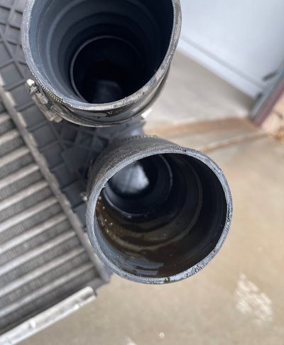

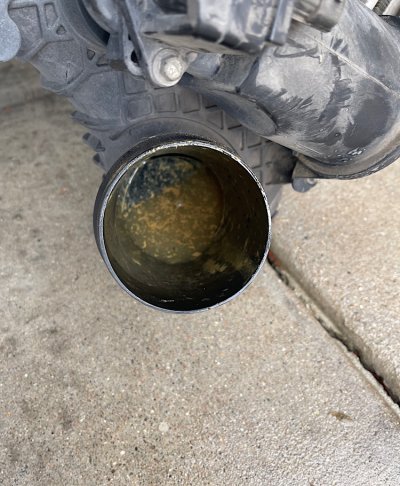

So you don’t think any of that vapor and oil or extra vapor and oil blows by the rings with the fuel without one? On our turbocharged SxS they may not have the same knock protection as the EcoBoost. With extra oil and water introduced into the cylinders it can change the effective octane rating resulting in a lower knock protection. We see a increase is dirty oil as well as the usual dirty intercooler and compressor wheel.
