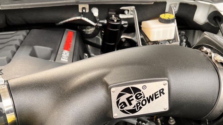

Just finished up the catch can and the air intake.
Waiting on the tune files to load the 93 street performance one on Monday [emoji48]
