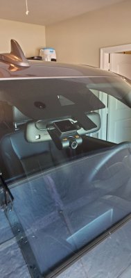

I installed a dashcam last night by tapping into the power behind the mirror as detailed in the radar detector forum. I have the ROAV S1 and used this cable.
https://www.amazon.com/dp/B07BFRWC3X/ref=cm_sw_r_other_apa_i_safuEbMKNJ0EX
So far it seems to do the job and was a very easy install. Cant even see it from the drivers seat (blocked by mirror), which was desired.

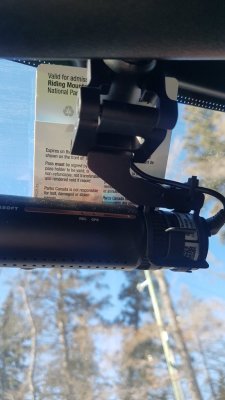

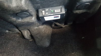

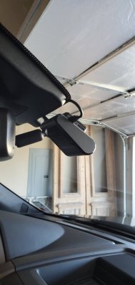

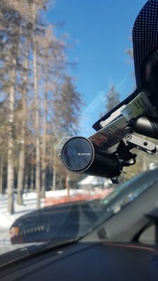

Finally took a couple pics of my setup, forgot to take pictures of the fuse taps, but used the same as @Lou Hamilton , been installed for almost 3 months now, no problems. Heated wheel still works. It's a Blackvue DR900S, with the Blendmount mounting attachment. I also installed the Blackvue Power Magic Pro hardwired kit. Mounted the box in the passenger foot well (right above where their feet are directly below the glove box) not visible, still accessible. Here's a few pics
