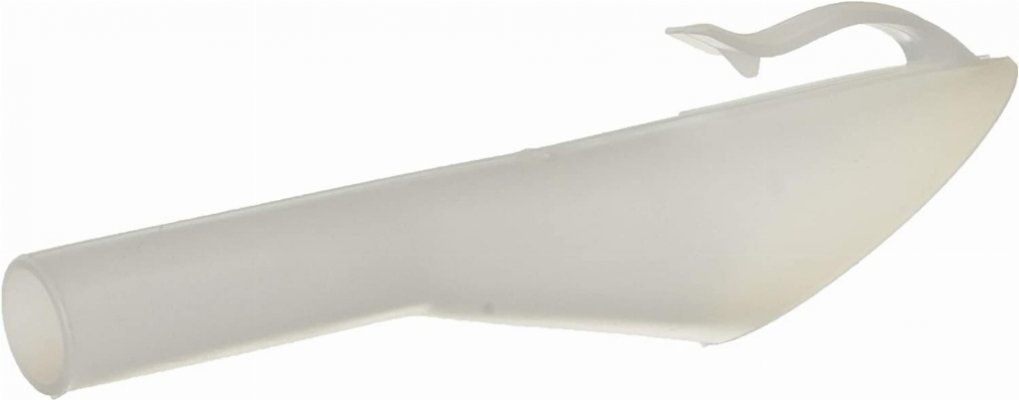

You need funnel that's the same size as a filler nozzle. There should be one in your vehicle next to the jack, in the back of the cargo area. Otherwise you can get one at Walmart or any auto parts store.
Here is what it looks like. 1 comes with each vehicle from the factory and is in the jack storage compartment, unless a previous owner removed it. If so they are cheap to buy online.
Ford 8U5Z-17B068-B Funnel
2009-2019 Ford 8U5Z17B068B
