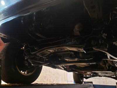

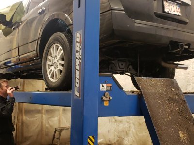

Had the coating done today. They said there was very little rust Just surface rust. I get nervous about rust considering where I live. I'd still be driving a first generation if they hadn't of rusted through.
Some oil got on the exhaust and he told me not to worry if it smokes, that it'll burn off quickly. I pull out of the lot and I started smoking like I was on fire! I'm surprised no one tried to wave me down. After a few miles the smoke was gone. I'm happy.

And the tech noticed I'm missing my splash guard under the engine. Must've been the previous owner. I'll have to hunt one down.

It looks like the sticky tar-like undercoating that I used to see years ago. Tar is a petroleum product I believe. It stayed tacky and pliable and you could always push your thumb into it and leave an imprint of your fingerprint.
oldpaddy
oldpaddy
May 1, 2012
355
76
Cape Cod
Nope. Not unless it has to dry further. It's like a thick oil. It's pretty wet. Similar to lithium grease.
TobyU
Apr 5, 2013
2,479
873
Ohio
Then definitely not the old tar stuff. It was sticky not oily.
