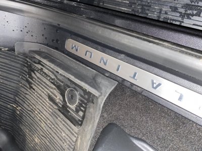

Went to pull my ‘20 Platinum Max into the garage after we got a good downpour (probably an inch or two of rain) and felt dripping water on my right foot. Looked under the dash and water was dripping from above the gas pedal. Looked to the passenger side and saw water on the floor mat. Walked around to look closer and the floorboard under the mat is soaked. I could see where water had been coming in within the door jamb near the hinges (actually to the left of the weather stripping, inside the vehicle). Obviously I’ll be contacting the dealer about this tomorrow. I have less than 1,0000 miles on my truck and I’m worried I’ll be chasing this issue for a long time. Seems extremely odd that a brand new vehicle would have this kind of issue. Anyone else experience this?

Finally got an update this afternoon. They said they “think” it’s leaking at the windshield gasket and they’ll replace the windshield and gasket on Tuesday when their specialist is in. I don’t have much confidence this will fix the issue. I have had various other issues already in the two weeks that I’ve owned it (front camera not working, tail lights full of debris, hands free liftgate not working, and the water inside the vehicle). I’m at the point where I’m wondering if I have a lemon on my hands.

Yes, I can’t say anything for 4th gen Expeditions, but windshield water leaks are a known problem for 1st and 2nd gen.
I had it happen on my new 2000 20 yrs ago.
The dealer does usually use a 3rd party repair company like “Water Doctor”
after my fix and a new gem module as it was the drivers side, it never leaked again

When the windshield is replaced I would want to be there watching. Had one done to a nice Camry wagon and 2 years later noticed rust at the leading edge of the roof. The idiot installer had cut into the metal with his knife when removing the gasket. They replaced the windshield yet the car had rust cancer that ultimately made it junk.

I have it for now until I take it back for the fourth time for additional repairs (non-leaks, LONG STORY). It hasn't really rained since the window was re-sealed so I can't say for sure if it's been fixed.
Theres a bulletin out on this. Needs an elbow on the AC drain.
I had seen that bulletin, but I believe that was for prior model years (hopefully if I remember correctly).

Bulletin says 2018's built on or after 8-31-2018. Hopefully you have it fixed!
