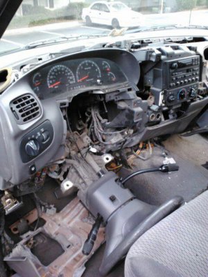

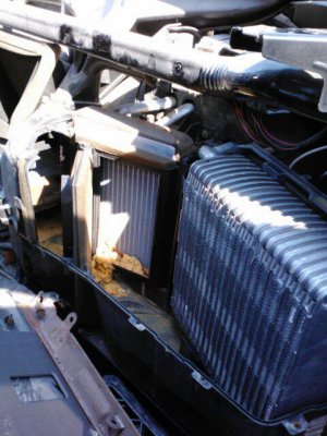

curleywon
Jun 1, 2010
61
Atlanta, GA
Got the radiator installed yesterday. Haynes manual said that the radiator fan needed to be removed, but I was able to push the shroud back far enough the slide it out without touching the fan. Today I removed the center console and steering column. Like Stamp said, It's not hard, just time consuming! I also recommend separating and labeling the screw and bolt locations upon removal. I'll finish up tomorrow. One question though. When I flushed the system there was a lot of rust and metal flakes in the solution. To insure that now of that gets into the new radiator or heater core, is it ok to flush the system without the radiator connected (engine off of course) to insure that I get everything out?
stamp11127
Mar 10, 2012
6,207
1,246
Temple, Georgia
Yep on the flush, I'd replace the water pump and flush through the opening for it. You can get quite a bit of crap out of that big hole. That is what I did when changing mine.
