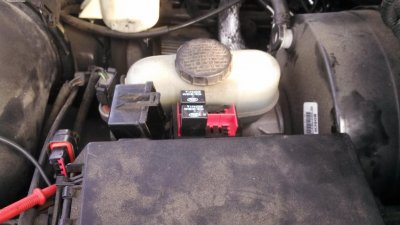

I had this recall done they put a wiring harness infront of the brake master , now I tried too use the cruise and it has failed I took the black tape off the inline fuse holder( two inline fuses) and found it corroded i'm going to bypass the ford fix to see if the fix was the problem
edit. the fuses are good
