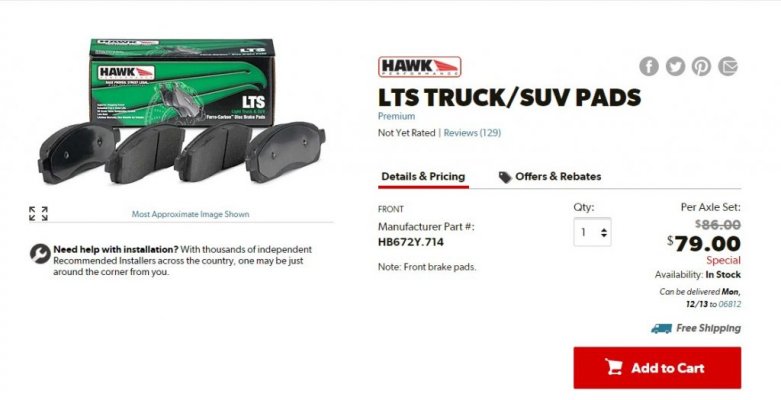

I used the below Hawk LTS pads and couldn't be happier. The bite and stopping power was so much better that I immediately replaced the fronts with the same Hawk LTS pads a few hundred miles later. To be honest, the rears made a huge difference and not so much the fronts. What's very much different besides the Hawk pad compound is that the rear pads have a much larger contact patch area than the Ford OE pads. I was at 3mm and on the fence as well. I measured the replacement OE pads brand new out of the box and they are about 10mm so if you look at it this way, at 4-5mm your a little more than half way worn down (say 75% to be safe since you cant go to zero mm). You just have to be sure there is really 4-5mm at the inner and outer pads since sometimes pads wear uneven if the slides are dirty and its usually the inner pads that get thinner quicker. Also - doing a 4 wheel brake fluid flush is a good idea for a better feeling pedal and can extend the life of the calipers and parts. Brake fluid absorbs a lot of water over time and many manufacturers only go 4 years between brake fluid changes. The domestic cars never took up on this but a brake flush will help with feel and I'd strongly recommend it if the vehicles is at about that age.
Thanks for the replies. I use those brake measure tool and my rear pads are around 4-5 mm. Will order the HawkLTS.
