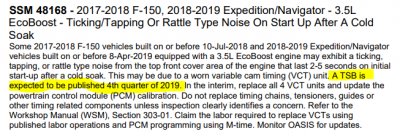

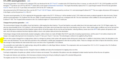

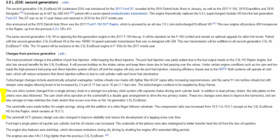

I was told by the service specialist that the replacement parts are a new/improved design, though I haven't been able to find anything on that specifically. Does anyone know whether this is fact or fiction and what exactly has been changed?
