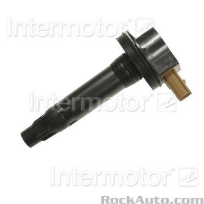

On the '17, all you have to do is to break the vac seal formed just under the coil by heat/cool cycles and a nice soft rubber seal...............a blade under the lip of that seal pried up will make them easy to remove.....go to Rock auto and look at one, you can see how it would seal over time...
Did mine a couple weeks ago...there are pics somewhere here....

I'm referring to these.....there is hardly any resistance at the plug...it's all at the upper seal & the cover. You need to break that deal all around as much as you can first. If you are sharp enough to do these, you got it....you just didn't know the "trick". Stay cool and don't get stupid with it and you'll save yourself some bucks. I joke to myself when I begin to "get twitchy"....trust me, it helps!
I used to have issues with removing the boot on my 5.4's but these really aren't anything like them, once you figure out the secret.....also, pre-spraying around the seal with silicone may have helped as well as starting and warming the engine first a bit.
