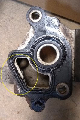

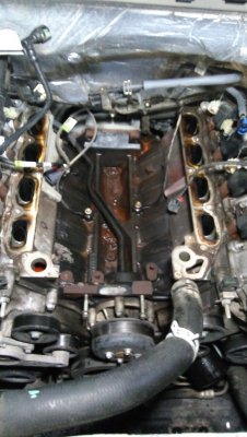

Coolant weeping into #5 plug cavity from crossover pipe causing engine miss. I removed the intake manifold and crossover pipe and saw plastic gasket deterioration at thermostat side of crossover pipe.
Question: What else should I consider replacing while the manifold is out? Water pump? Detonation sensors? I ordered new Ford coils.

If it were me I would be changing the water pump with the motorcraft unit as well as The tensioner and 2 idler Pulleys. Preventive maintenance is peace of mind.

In this case, I might replace the pulleys and tensioner. I've had those fail on the road before. They can seize unexpectedly.

I just replaced my tensioner and idler pulleys and waterpump with motorcraft units. That's the only thing I would have used. They are readily available and not terribly more expensive over the crap generic parts.

The water pump and cooling system are stupid easy to get to on these things, even with everything in there. At this point if its not giving you issues and you know you have had a proper and fresh 50/50 coolant in the system I would leave it be. I replaced my water pump and all hoses in my 09 with 180k on the clock. The water pump looked and felt great still but were are not the original owners so I didn't trust the maintenance.
I would replace the heater hoses in the engine bay and the radiator cap though. The Hoses are the weakest links, and the radiator caps never last, I like the ones with the red safety lever that allows me to bleed the pressure off safely.
I would spin every idler pulley and if any of them are super easy to spin or sound even the slightest bit dry I would replace it.

Photo 33291 should be replaced
JB weld wont hold well enough to prevent coolant leak, oil leaks or even gass leaks so if its broken replace it.
Next I would blow all the liquid out of the open holes and place clean shop rags in all those open holes and clean the surgaces surrounding them, you want smooth clean surfaces when you replace your valve covers and intake manifold. Go ahead and add a new thermostat, hoses, radiator cap and I had to replace some of me hose clamps cause they didn't tighten up enough. My 2000 was a pre owned by 2 before me and wasn't treated well.
