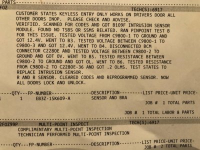

I had my 2018 Expedition serviced on Monday for smart locks not working on any doors and I had start / stop not working for few month. they diagnosed it as intrusion sensor failure and replaced the part (EB3Z-15K609-A) all door locks started to work normally and engine start / stop started to work as well. may be a coincidence.

have your dealer inspect intrusion sensor. I had mine replaced on monday for the same issue - only driver door's smart lock was working and start / stop was not working at all. they replaced intrusion sensor and everything is working now. Part replaced EB3Z-15K609-A
That’s interesting...I wonder what the connection is. Perhaps a faulty intrusion sensor is a battery drain? Because it’s absolutely a battery issue, so I’m just trying to think of the connection between the two.
Thanks!
X2 on that. Could this sensor be the drain we are looking for. If I charge by battery all the problems go away. I just don’t drive mine much right now.
