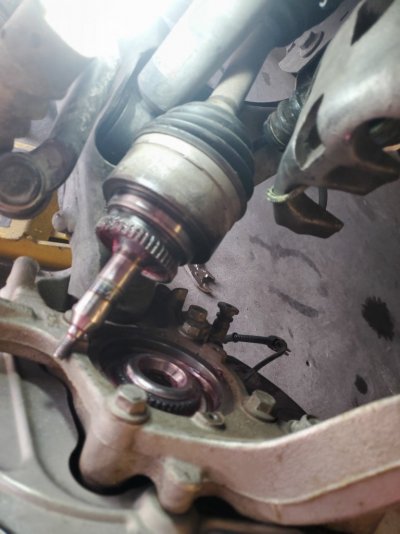

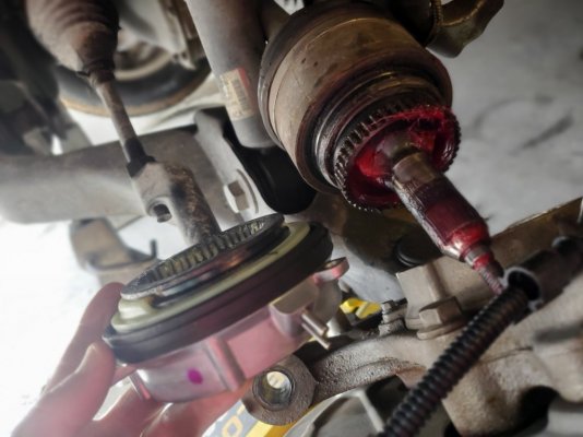

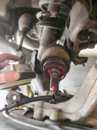

I had a similar issue- all my checks of the vacuum system showed good. Everything seemed to lock and unlock like it should while in the garage. But on the road- funny grinding noise. Put it in 4hi, noise goes away.
I installed the RCV lockouts and haven’t had a problem since. My lifetime MPGs are 14.7, with a latest of 15.1 and a best of 18.0. And I won’t have to waist anymore time/money on the IWE vacuum system.
Just got all the stuff to that this past weekend. I will be heading to the auto craft shop to knock it out in the morning!!!
