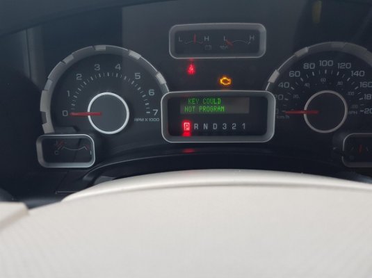

I have a similar issue. I bought 2 eBay keys and tried to program them after having them cut at a locksmith, using my existing 2 keys (originals).
The Expedition just flat out refuses to program the aftermarket ignition keys. Here is a pic :
I spoke to an acquaintance of mine who works as a mechanic at Ford (very knowledgeable guy) and he told me that "jobber keys are garbage, always fail" and he never uses them. "Get yourself an original Ford key", he said...
I'm still hoping that the truck is simply locked to a set number of keys (I've read that the default is 4) and that it simply needs to be put in "fleet mode", where you can actually have an unlimited number of keys. This requires the Ford software at a dealer, unfortunately.
I'm going to see if he can help me out with this when he has time... but apparently, even if it works and fleet mode allows me to program them, the jobber keys will always be prone to failure.
Damn, wish I knew... :(
Oddly enough, I could program the door lock / unlock feature on both eBay key FOBs no problem by following the door lock programming procedure. They work fine for that. In my case, it's the ignition chip in those eBay keys which refuses to program into the PATS.

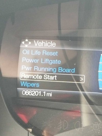

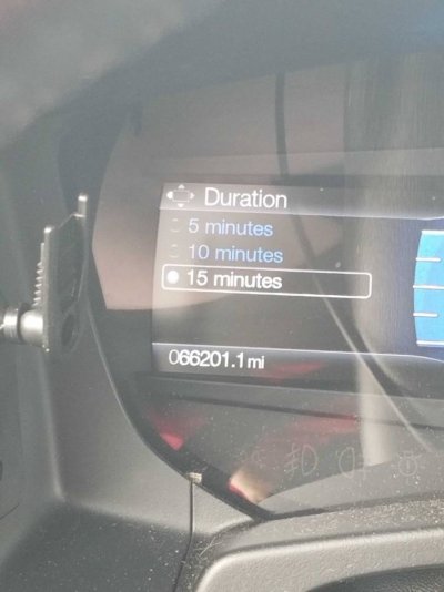

Remote start, using a Ford Smart Key.
Press button 2, Lock Button once.
Press button 1, 2x button twice.
2, 1,1, should take less than three seconds to complete the process.
Engine starts, parking lights stay on.

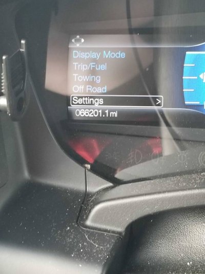

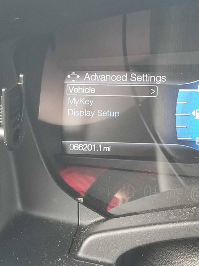

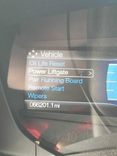

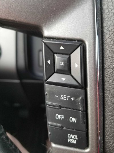

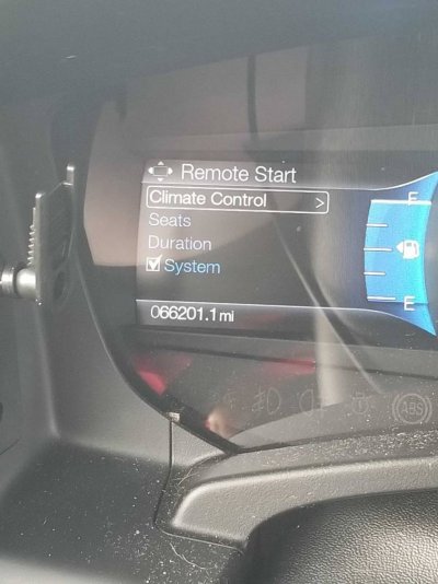

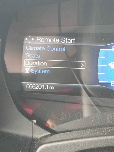

If you go into the MFD menus's on the left MFD display. Select the following options using the left steering wheel navigation buttons. Navagate through the menus using the up or down button, then the right arrow button to get into the submenue. Once you get into the submenue related to Vehicle, if the remote start option is visible the vehicle is so equipped. The following menus after selecting remote start have to do with how the environmental controls are set automatically by the remote starting process, its all very inituative. The time submenue of duration has to do with the length of time the engine runs and then automatically shuts down.
NOTE: The remote start system limits the number of times you can remote start the vehicle, then you are locked out of the system for a rest period, actually, you need to start the vehicle normally for the rest period to reset and allow you to use the feature again. That all said, as my system is set, I have 3 15 minute remote start cycles before the rest/reset needs to be done. Total remote start runtime of 45 minutes.
NOTE2: If you want to shut the vehicle down while the engine is running after the vehicle has been started remotely press the 2x button once and the vehicle will shut down, and return to standby start. You can remote start one or two more times depending on the remote start cycle you stopped the engine in. Then the engine remote start enters rest/reset, you have to start the vehicle normally. Or, you can enter the vehicle with the engine off and start it normally. The press brake and push start button procedure.
NOTE3: The standard as built remote start option WILL NOT INTERFACE AND/OR FUNCTION WITH THE FORD SYNC APPLICATION, FORD PASS, FOR STARTING, LOCKING, UNLOCKING THE VEHICLE VIA A CELL PHONE. I am going around and around with my Ford Dealer on this. They tell me a seperate module needs to be installed, $ 185.00+ and you must pay a monthly fee for the service. I think its a bunch of hooey, like the heated steering wheel, one Ford Tech swears, my vehicle did not have, but did, when I set it up using FORSCAN.
