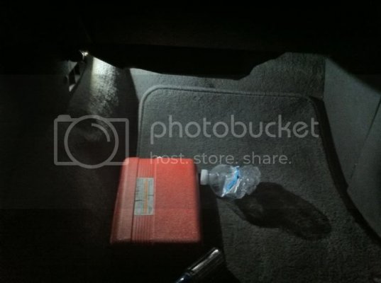

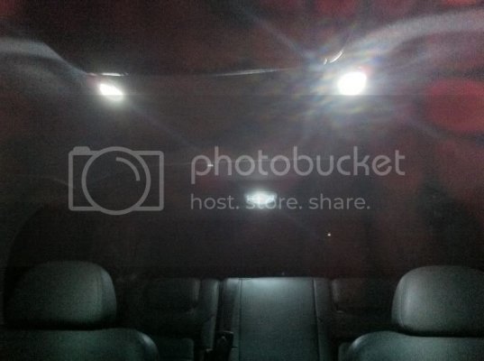

I got my LED lights on Friday and quickly went to work. I am waiting for the correct puddle lights to come in and will have those swapped out soon.
I think the whole kit requires (5) t10 bulbs and (3) 578 bulbs w/9 SMD led lights. The floor lights consisted of using the bulbs that wouldn't work for the puddle lights, 31mm w/2 big SMD led lights.
Added lighted floors to the dome light wiring.

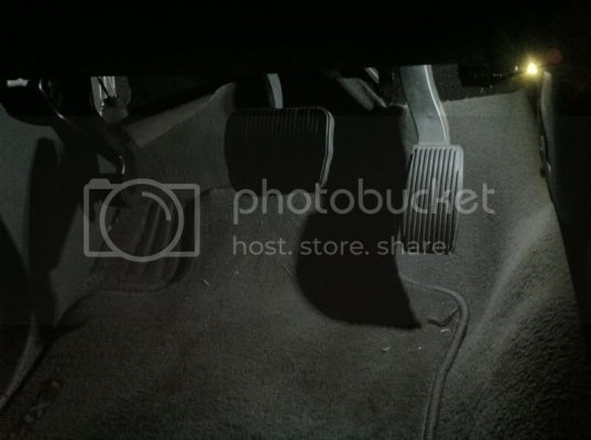

I used these lights for the floors, 1 on each side.
http://cgi.ebay.com/ebaymotors/ws/e...item=&sspagename=STRK:MEWNX:IT#ht_3519wt_1014
I couldn't use them for the puddle lights because they seemed to draw too much for that application and wouldn't turn on. I tried my other 578 bulbs that had 9 tiny SMD led lights on the puddle light wiring and they turned on just dine, so I ordered a set of those in 31mm for that application.
Sorry I don't have pics for these steps, it was 12:30am when I did this.
Step 1: Used a soldering iron and melted the end caps off, and attached wire and chained one LED to the other giving about 4 feet of wire between them.
Step2: Attached them under the dash using 3m r/c-car style double stick tape and made sure no wires were visable.
Step3: Ran the lead wires up the driver's side piller, then across the ceiling to the over-head console and tapped into the dome light trigger so they only turn on when the dome lights are activated.

The dome lights have 2 power leads, one to turn on when you manually, and one that powers them when you open the doors or hit the dimmer dial. I have them wired to to only come on when the doors are opened, etc.
