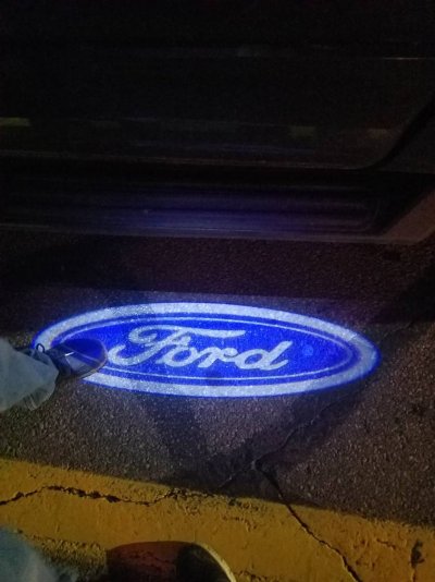

Had a busted puddle light, 20 bucks spent on Amazon later....wow, soooo much prettier.
PS brand: MOFORKIT , not sure if they're different but this one had slightly better star reviews

I thought I had one light go out, but it was just a loose spade terminal. Another member sent me these!35c4370955e812387a6642bb3f8638a2.jpg

Your not the same user that sent them to me. Have you replaced them yet? I'm wondering if your connections are just poor? That's what was wrong with mine in the 1st place. I did think it was odd that a 2017 would burn a bulb, when I've never had to mess with my 05 Suburbans. But yeah all 4 of the spade terminals were loose on my Ford puddle lights.

Mine are aftermarket LED. The connections are absolutely tight because I twisted, soldered, and marine shrink wrapped them. No plugs...so yeah the LED circuit is going bad.

So then your logo lights are different than mine, as they are plug and play. So I'm not sure where they came from, but there are several on eBay.

With spades, squish em with pliers then wrap them off with electrical tape so they don't short....
the Ford OEM puddles had spade plugs instead of loose wires, so the connectors couldnt touch
