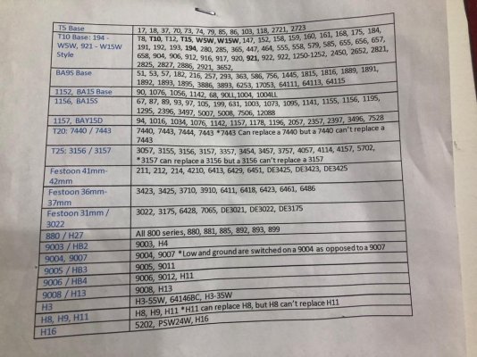

Not sure what you mean by that, can you be more specific? I am a guru when it comes to led lighting so any question you have I can probably answer and even tell you what bulbs your vehicle takes

So no that is incorrect your expy uses 9140. I would buy the Auxito 9140 or the zdatt 9005 (interchangeable). I would actually go with all of auxito for fog, low & high or zdatt for the same. A benefit of the zdatt is it comes with color filters so you can change between 3500/4000K, 6000K, & 8000K color temperatures

Unfortunately, and I'm not sure why, Amazon fitment guide is not always correct. I purchased those exact LEDs for my fogs, in fact that is the link from my "Orders History" from my Amazon account. They fit my 2020 XLT perfect. The links I provided are EXACTLY what is installed on my 2020 XLT.
Actually, yes it is correct... Amazon in this case was wrong. Another note... be careful just ordering a "9140". I did that the first time and contrary to what you might have thought - it was the WRONG fitment. The 9140 does not specify what base type is used to screw into the assembly. So that is the important part. For the fogs on my 2020, you want the H8. That (H8) is also the same base fitment as the H9 and H11. Originally, I ordered a 9140 H10 and the "H10" is not the correct base fitment although the foglight bulb number was 9140. So be careful!

These are the ones I ordered originally (under the belief I should just look for "9140"). Note they have "9140" in the description. They had to be returned because the base fitment is "H10" instead of H8/H9/H11. The links I provided above will get you want you need - promise ;)
WRONG ONES --> https://www.amazon.com/gp/product/B07TRVH9ND/ref=ppx_yo_dt_b_asin_title_o06_s00?ie=UTF8&psc=1
