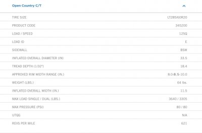

I am guessing one will still have to run a spacer if you want to run 33”+ tires.
