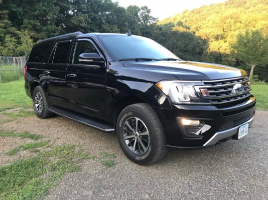

Well my wife finally decided today (own her own) that the lower valance on the front bumper needed to go. Needless to say I did not argue and it looks so much better.
I still don’t understand why they put these on in the first place. To me it looks like it will cause wind drag.

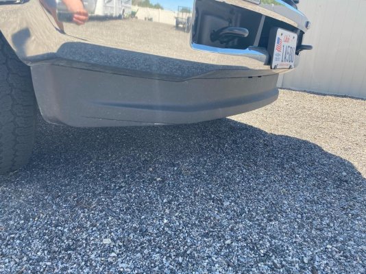

They are believed to be quite effective, and I have heard rumors of a 1 mpg or more difference at highway speeds. It is probably exponential, so the faster you go, the more mileage you will lose. TTBOMK, the FX4 has a more truncated version. I do not know the degree of one vs. the other, but eventually I will remove mine, and add it for longer highway trips.

I just don’t see how they are fuel efficient. It would be different if they curved back some instead of being a flat wall, plus it just looks stupid on the front.
