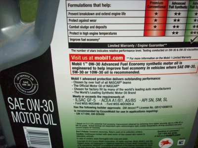

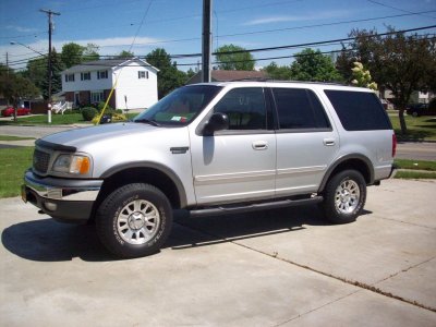

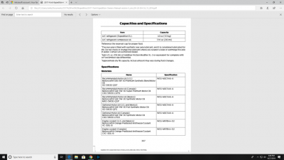

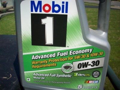

100_1475[1].JPG 100_1476[1].JPG 100_1474[1].JPG Meets Ford requirement WSS-M2C946, My rust bucket, is in excellent shape.

Pg 307 of the 2017 Expedition's owner manual. Until Ford puts out an additional approved oil, 5w30 is all it gets.
